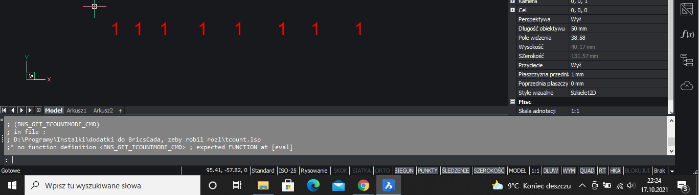

Im had been lookig for how to use TCOUNT in BricsCAD till I found that link
https://www.cadstudio.cz/en/download.asp?file=count.lsp
I downloaded and installed that lsp and it is working till specify starting number and increment that ask me for (choose objects and sort selected objects (via X or Y)). ad after question for specify starting number I write in <1,1> or any other combination i get communicate like that
What can I do to use correctly works TCOUNT guys, please help me

Our LISP tools are not supported in BricsCAD and other AutoCAD lookalikes (copies).

Bricscad Express Tools include a TCOUNT routine.
Available in the Bricscad store, or author's site: www.cadwiesel.de
