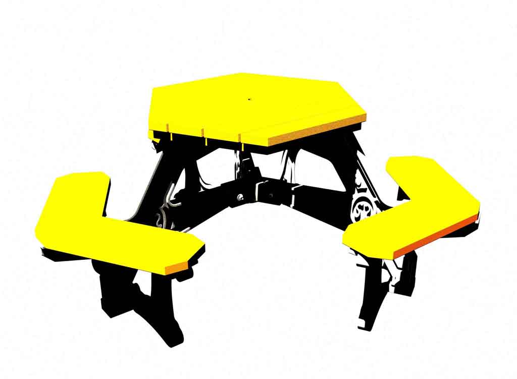

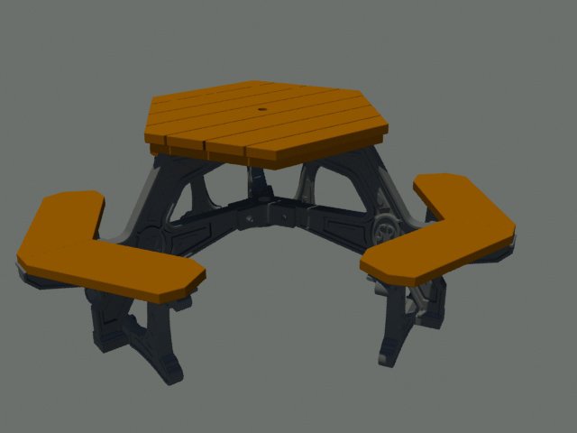

Can anyone tell me why I get a completely different color on my renderings then I have on my view? Also what would be the very best possable rendering set? For instants the best I have found so far, and it is not very good at all, is 40mm IMAX (cine) 4096x3003, my preset set to mental. ray.no.gi and set to production.

What do you mean by "different color"?
Can you post some images so we can see the difference? |

I believe it is a
lighting issue. I switched from target spot to sun light and now get a better render. Before the brown was a bright yellow. Below is a rendered view. I am getting closer however still not the realism I am looking for. Thanks |

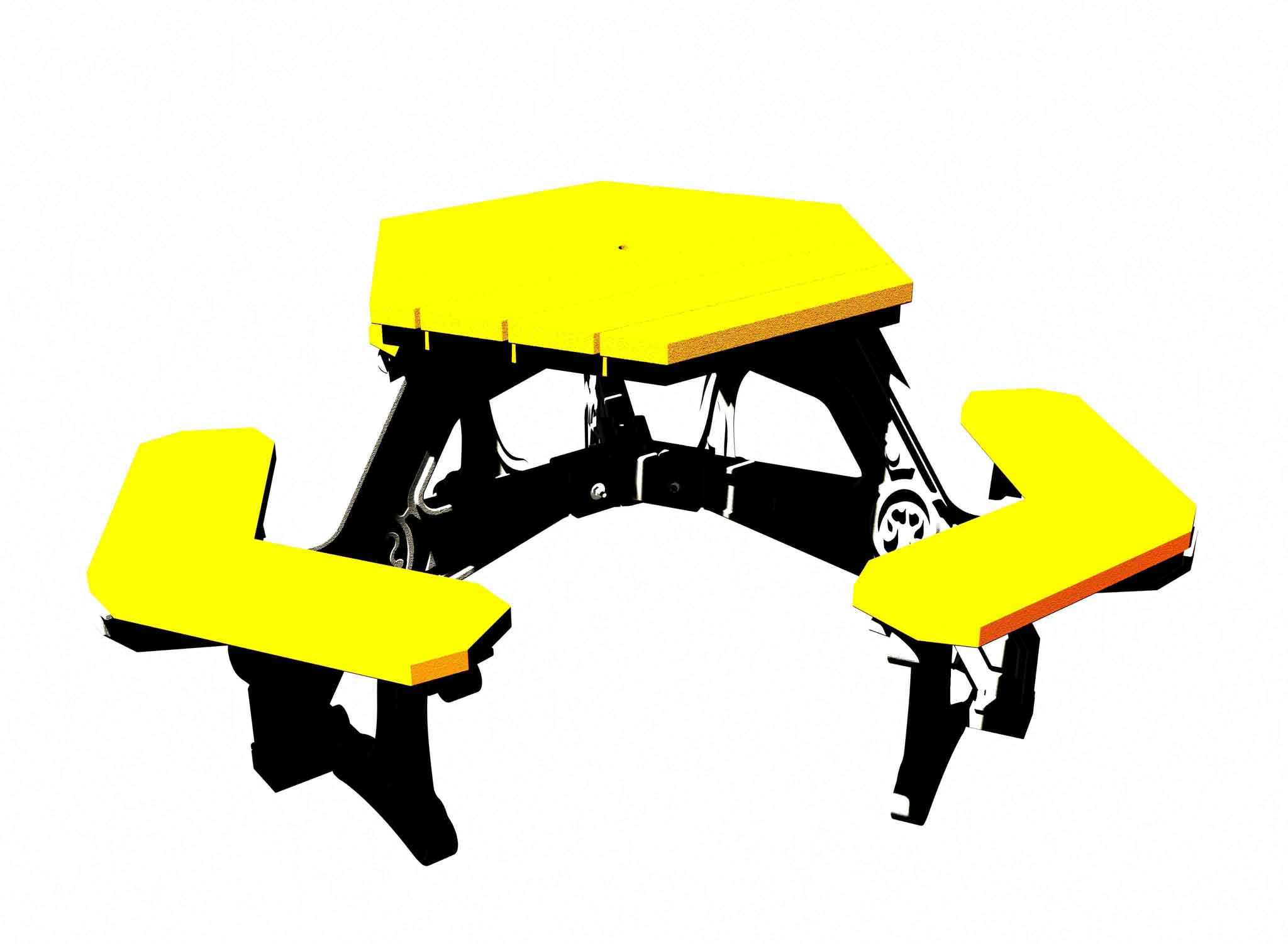

Here you go its back. I change to 70mm IMAX (CINE) AND CHANGED THE PRESET TO MENTAL.RAY.NO.GI and i get this ugly result.

Yes, there is definitely a problem with your lighting. The scene is just getting blown out. You may need to adjust the settings in the Environment dialog, (Rendering menu > Environment). Try the various exposure control settings.
You may also need to adjust your Gamma/LUT settings, (Rendering menu > Gamma/LUT Setup). Read through the Max Help files for instructions on how to adjust your settings. |
