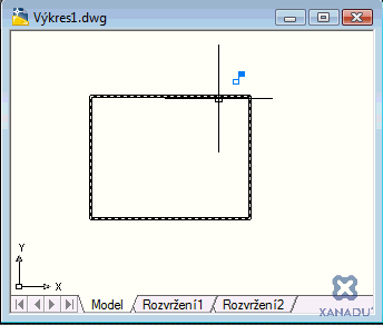

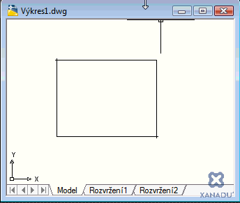

Compare the following two animations - they illustrate the behaviour of two similar objects. The first one is a normal rectangle created using the standard AutoCAD command. The second one is a true rectangle ("rectangle on steroids" if you want), which also behaves like a rectangle during grip-editing and other AutoCAD editing operations.
Standard rectangle (polyline)
True rectangle (constrained polyline)
So how to get a true rectangle from a standard rectangular polyline (pline)? Just a single "magic" command is enough: AUTOCONSTRAIN. With this command you will add automatic geometric constraints to the selected object - and these constraints will be then kept also during editing.
