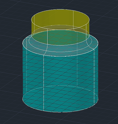

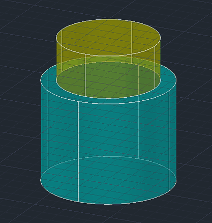

How to fillet a touching edge (intersection line) between two 3D solid bodies? The standard command FILLET can fillet an edge of a single solid but not an intersection edge between solids.
Before filleting, you need to union both solids into one - with the command UNION.

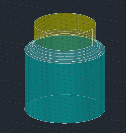

Then you can use the FILLET command - select the unioned solid through the edge you want to fillet and specify the fillet radius.
filet, rádius
Another option is to use the FILLETEDGE command available since version 2011 - here you can again just select the edge or loop to fillet and specify the radius:
