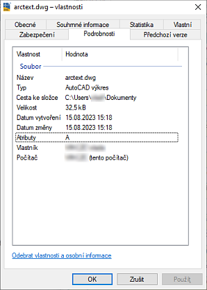

In the properties of the file, on the Details tab, I see a lot of my personal information. How to remove them and how to anonymize the file - e.g. a DWG file? The "Remove properties and personal information" link does not help.
In the case of DWG and other CAD and BIM files, these properties just reflect the current location of the file, they are not metadata stored in the file. When you copy the file elsewhere, these properties will show the new location and "ownership".

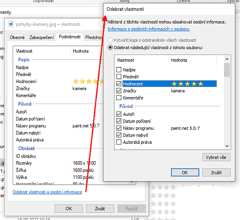

Personal data in the Windows Explorer sense is managed by default only for certain types of images and media files. There, you can remove the information you add (/tags, ratings, license...) in the way indicated:
