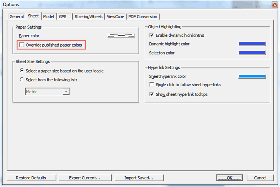

Table embedded into an Inventor drawing is not visible in DWF.
A - answer An Excel table inserted into an IDW drawing which is subsequently published (exported) to the DWF format is not displayed (is invisible) in the DWF viewer.
Check the application settings in the Autodesk Design Review ovìøte viewer - see Options > Sheet tab > Override published paper colors checkbox. Uncheck this option:
