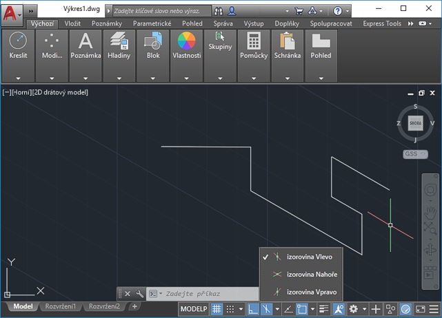

Why does AutoCAD display an oblique (skewed) plan view and a red-green crosshair?
A - answer AutoCAD suddenly displays a skewed underlay grid and the ortho mode in a plan view draws diagonal, oblique lines:
Yoh have probably set an ISO-view - an isometric drawing mode. See the AutoCAD status line icon and see the command ISODRAFT or the variable SNAPSTYL.
