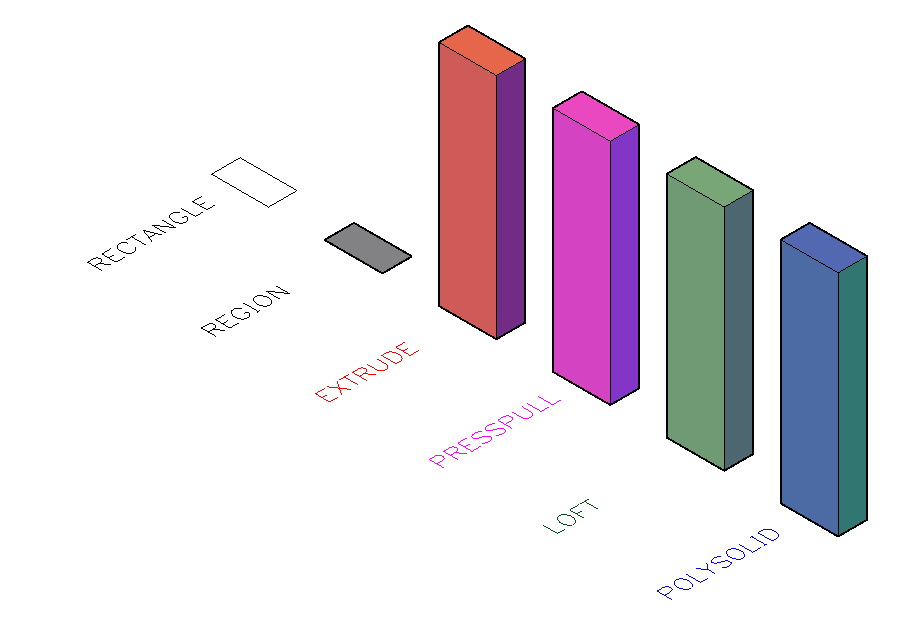

From left to right we have...
Polyline rectangle.
Rectangle converted to a region.
3D solid created from rectangle via the Extrude command.
3D solid created from a rectangle via the PressPull command.
3D solid created from two rectangles via the Loft command.
3d solid created without a rectangle using the PolySolid command.
Visual style = Conceptual.
Edited by John Connor - 23.Jun.2014 at 20:21

blue: If you are drawing kitchens and bathrooms you would most likely want those objects to be 3D solids and not surfaces.  But even surfaces will "shade" when viewed in a conceptual or realistic visual style.  I'm not sure you would be interested in "volume" per se unless for some reason you wanted to compare what a base or wall cabinet would weigh in both pine and oak for some reason.

Blue and John, OK region is not the only way to create a 3D volume but sometimes you will be able to create a 3D "thing" but it won't be a volume but a 3D surface ( you see it when the created 3D ting is loaded with a lot of curves that you don't see normaly ).
When you have 3D volumes you will be able to have informations on it whith the command MASSPROP.

Regions are only one way of creating a 3D solid.
