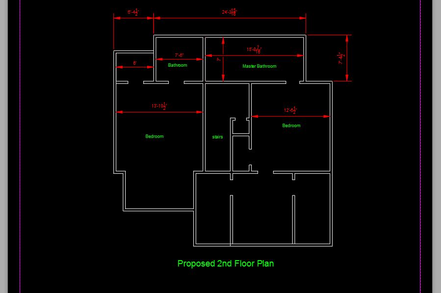

I got it figured out. My drawing was drawn in inches instead of feet. All I had to do was scale it up by 12. Problem solved. Thanks for everyone's input. Really appreciate it.

Direct Link To This Post Posted: 21.Jun.2017 at 15:27
A screen shot of your floor plan using a viewport scale of 1/8"=1'-0".  Note that the text and dimensions are on different layers which is readily discernable because I have assigned those layers a different color.  This also means I can turn those layers on/off or freeze/thaw them if I wish.
The magenta lines are my viewport which I put on layer VPorts.
The floor plan itself is on a layer called Walls.
Note the dimensions (feet / inches / fractions of an inch).
<<AutoCAD 2015>>

Direct Link To This Post Posted: 21.Jun.2017 at 14:49
Actually it is the insertion scale that is set to Feet and NOT the drawing units.  Your drawing units are set to decimal inches which can be easily verified using the -DWGUNITS command (note the presence of the dash).
The reason why everything looks so small in your viewport when you assign the scale of 1/4"=1'-0" is that AutoCAD assumed every dimension you entered was in inches and not feet (or feet/inches).  I would have set the units to Architectural and accepted the default precision of 0'-0 1/16".
By the way, I don't think you will be able to get the floor plan plotted out at the scale that you want and have it fit on an 8.5x11 piece of paper.  The floor plan measures 34'-11" side to side and 33'-9" front to back.  Your paper size, if you drew right to the very edge in both directions will only accommodate 34'x44'.  And that's only if you don't include a border.  I would either change the scale to 1/8"=1'-0" or plot to an 11x17 size thus allowing you to retain the original scale you had in mind.

Direct Link To This Post Posted: 20.Jun.2017 at 17:58
So can we assume you started with the default template file named acad.dwt and not the metric version named acadiso.dwt?
If you want to print the drawing out at a scale of 1/4"=1'-0" then shouldn't you also be printing to a 8.5x11 sheet of paper?
Please attach a copy of the .dwg file to your next post so we can have a look see.  That should end all doubt.

Well like I said its been nearly 20 years since using auto cad.  I started drawing without any thought to the settings until i got further into the project.  I was drawing in decimal feet which i figured was fine.  The page set up settings have been confusing to me although becoming more and more clear.  Are you able to tell me how to fix it?

Why are you using imperial units for the drawing scale yet plotting to a metric paper size AND using a metric scale of 1mm = 1 unit?
You are mixing apples and oranges and expecting it to work?
