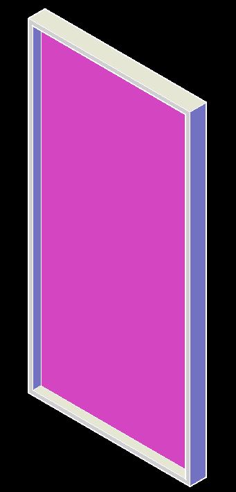

Yeah this is the effect but your rectangle is open on one side, i want it to be completely closed from each side.
So you have a Recangle with an inner cavity.
EDIT: I tried setting a new Work Plane behind the actual workplane and then extruding a rectangle and it works !!!! Just have to pick "Offset from Plane" and set a new plane in the thickness you need from the actual plane <3
Thanks for your help lovely dude! :)

Is this the affect you are trying to achieve?  In my example the rectangle is 200x400 and has a thickness of 20.  The "cavity" is 10mm deep.
