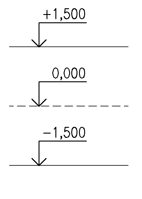

Hello,
we released final version tool (1.63) and dynamic blocks for dimensioning spot height in architecture and civil engineering at Autodesk AutoCAD.
Package contains:
  • czech and english verison tool and blocks,
  • icons for commands,
  • examples,
  • tutorial.
Thanks all for comments and feedback during develop.
alfred and PepaR

Thank you for your answer, it was helpful. Alfred tried to modify LISP. We upload new version, that support inches and feet. We need somebody for testing, please – somebody who is accustomed drawing in inches and feet. You can find two files with examples – for inches and for metric units.
Command list in LISP:
  • function VKS: insert dynamic block and to attribute write height (ad val Y coordinate and current UCS). For values >0 use prefix '+'.
  • function VKS-NADM: the same function as VKS, but for values >0 don't use prefix '+'.
  • function VKS-POLE: insert dynamic block, in attribute is automatic text field width value Y coordinate.
Other commands:
  • function VKO: for updating height in attribute value after moving blocks or change UCS. It os for blocks inserted by function VKS and VKS-NADM.
  • function VKNULA: setting new base level
