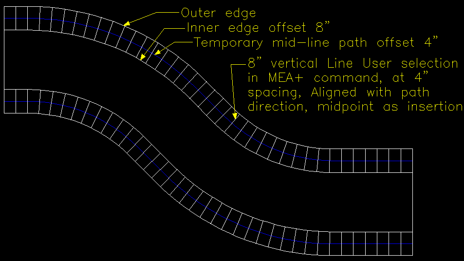

Check this out:
You can use the MEA+ command in that to establish your curved edges.  I would recommend offsetting a temporary center-line-of-the-bricks-along-the-edge route, and using either a rectangular Block defined with its midpoint as the insertion, or if you don't want the double lines at the joints at small scale (see image), you can use just a Line with its midpoint as the reference location for placing them along the route.  Unlike regular Measure, MEA+ lets you place a User selection [the Line if that's what you choose] in addition to the Points and Blocks options, and lets you specify any angle Relative to the route, not just 0 or Aligned, so if you use a Block orthogonally defined, you would presumably use it at 0 or 90 degrees relative to the route, depending on how the Block's definition is oriented and whether you want a soldier-course or running-course edge.  MEA+ and its companion DIV+ command also have many other enhancements over ordinary Measure and Divide.

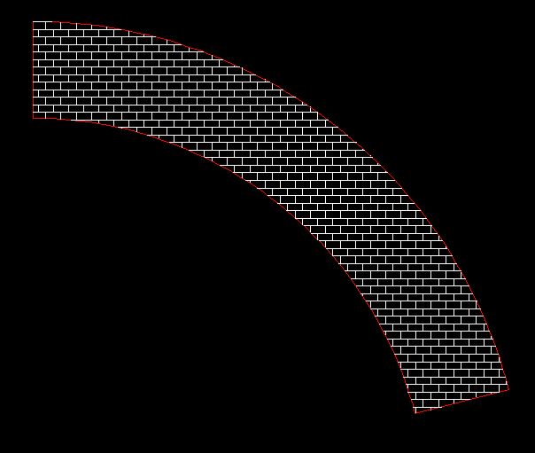

Forget the border for a moment.  Is this how you run the brick around a curve?

Direct Link To This Post Posted: 01.Nov.2013 at 16:37
AutoCAD 2010?  Does that have a path array option?  If so then it might work for the border.  In the field of brick or pavers remain in a straight line I suppose you could hatch an area larger than your walkway, drop your walkway over it, explode the hatch and Extrim everything outside the edge of walk.  Exploding hatch patterns is not usually recommended though because it can balloon a drawing's file size but I suppose that would depend on how much hatching was involved.

Direct Link To This Post Posted: 01.Nov.2013 at 16:30
Hi John, The field of brick or pavers would remain in straight line. The Border is what I need to populate with side by side brick along a curved line.
