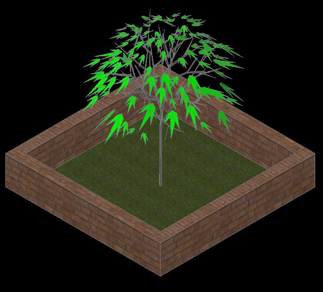

Thought I'd tweak it a little bit.  Now I don't normally work with materials or even do renders but I was able to come up with this small retaining wall enclosing a grassy area with a 3D tree I downloaded from the CAD Blocks section of this website.  The next step would be to light the scene (sunlight of course).  That would depend on one's geographic location, the month, day and time of day to be set prior to rendering.
BTW....the above image is not a render.  I used the Realistic visual style.  It would look better if rendered.

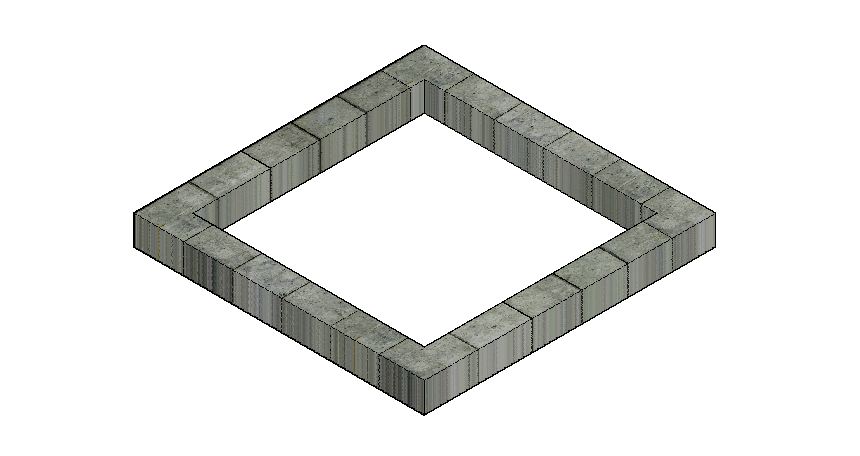

A 3D wall with a concrete block material applied.  Visual style: Conceptual.  I did not play around with the material mapping feature very much.  I just sort of eye-balled it just so you could get a rough idea.  It would need more work obviously.
This is about as far as I want to go for the moment.  You really need to work on your basic 3D skills before even attempting something like this.
If this is for a school project then I suggest you consider using the free version of SketchUp as you'll find it easier to apply materials to 3D objects.

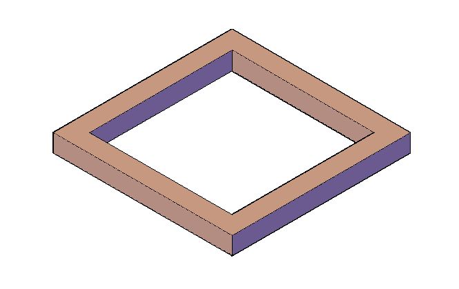

By the way, this is what a 3D wall might look like as viewed using a Conceptual visual style.  No materials have been applied yet.  The color in this case is derived from the layer the wall is situated on.  As far as the eye can tell this could be either a solid or a surface.  Since I know how I created it I can assure you it is definitely a solid.
