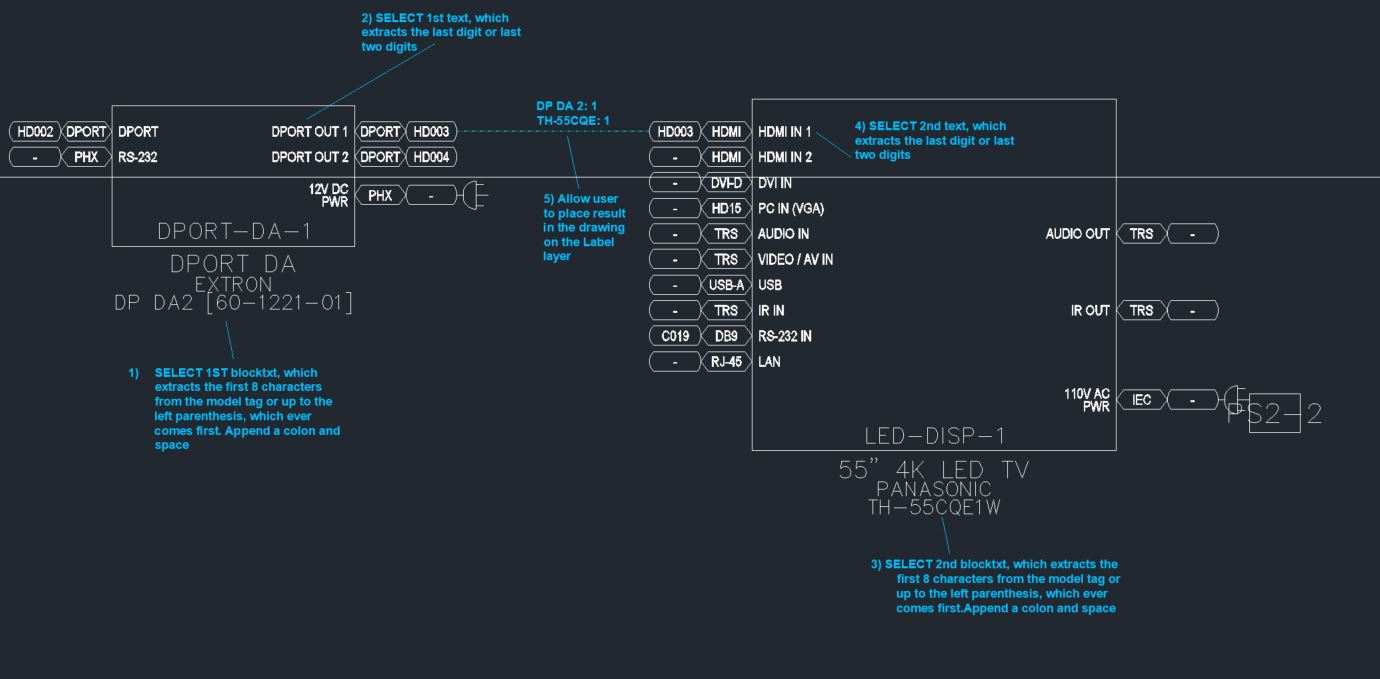

I could use some help with creating a LISP file to generate wire labels. Here is how I would like the program to work (see screenshot).
User loads and runs routine
1. User is prompted to SELECT 1ST blocktxt. Program extracts the first 8 characters from the model tag, it skips counting spaces. Or extract all characters up to the left bracket, which ever comes first. Then append a colon and space
2) Next the user is prompted to SELECT 1st text, which extracts the last digit or last two digits.  If there are no digits at the end of the string then extract the last word (eg OUT). Then append a line break
3) Then the user is prompted to SELECT 2nd blocktxt, program extracts the first 8 characters from the model tag, skip counting spaces. Or extract all characters up to the left bracket, which ever comes first. Then append a colon and space
4) Next the user is prompted to SELECT 2nd text, which extracts the last digit or last two digits.  If there are no digits at the end of the string then extract the last word (eg OUT).
5) Allow user to place resulting mtext in the drawing on the Label layer
Here is the desired results on the Label layer from the drawing and pic below
DP DA 2: 1
TH-55CQE: 1
I found this LISP that extracts all text from multiple blocks and converts it to mtext.
https://autocadtips1.com/2011/04/26/autolisp-attribute-to-text-mtext/
And this LISP combines multiple selected text in to one mtext
http://www.lee-mac.com/text2mtext.html
I thought these  two LISPs might be helpful as a starting place.
