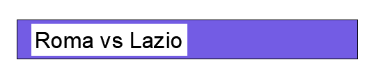

How do you change the color of the text to white?
This is what I've done:
1. Make a rectangle
2. Make the text inside the rectangle.
3. Apply hatch (solid) inside the rectangle.
And this is the result:
How to make the white background like above pic to same color as the purple background?
