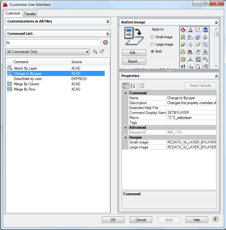

so here is what I am trying to achieve:
I typically like to draw in my P_DIM layer that is set to a different color other than ByLayer. This means that when I am finished drawing and I flip it to the correct layer, it needs to be adjusted to ByLayer for all properties.
I'm trying to create a command that will change THE SELECTED object(s) to ByLayer for Color, Linetype, and Lineweight.
Closest I've found is
^C^C(setvar “cecolor” “ByLayer”) (setvar “celweight” -1) (setvar “celtype” “ByLayer”)
But this sets the current drawing properties to bylayer for all the above mentioned. Attempting these variables without the ^C^C still sets the current draw type.
Is there a function that I am unable to find to set the color of the current selected object to by layer that I am missing?
If I'm reading this right there is a command in AutoCad to do this. "setbylayer" you select the object's you want to change then typ "s" to change the setting if you do not want it all to go to bylayer. answer the next two questions. and your done.
Or select the objects first and type "setbylayer" hit enter twice this will set every thing you selected to by bylayer.
