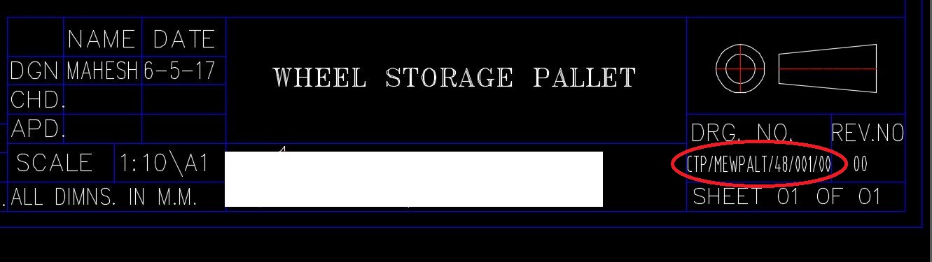

Direct Link To This Post Posted: 17.Aug.2017 at 06:56
FINALY I CREATED DRAWING NUMBER THANKS A LOT JHON

Direct Link To This Post Posted: 17.Aug.2017 at 13:04
It looks rather involved.  Can you explain what is supposed to mean?
