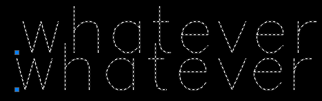

It could be either ROMANS or SIMPLEX.  I think the characters are the same in both, but the character spacing is a little different, and for some reason a left-justified string in ROMANS "starts" slightly to the right from the insertion point, whereas the same in SIMPLEX starts exactly at the insertion point.  Here, the upper one is in ROMANS, and the lower one in SIMPLEX, with insertion points vertically aligned [the blue grips]:
