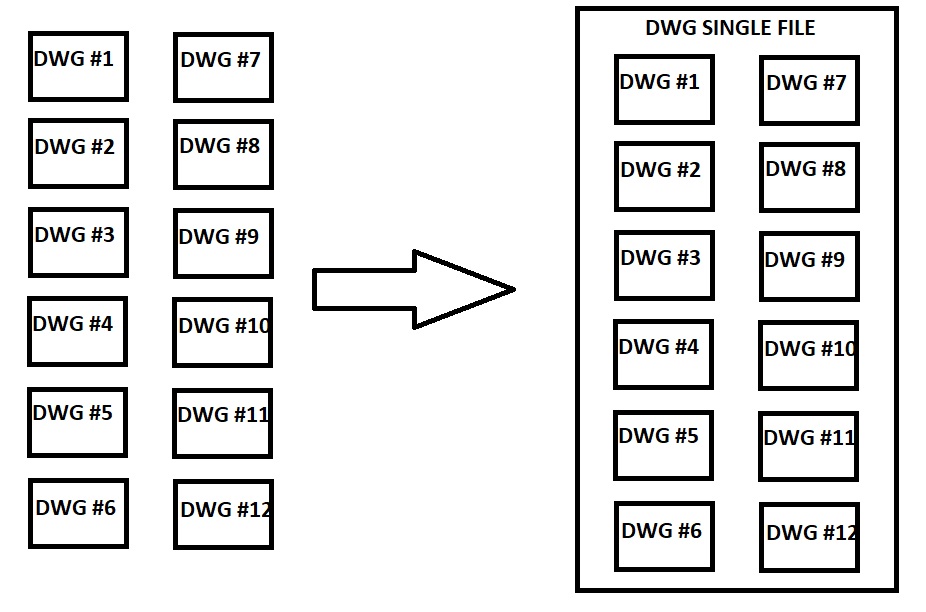

I have a work in hands where i need to take multiple DWG files and create a master one where all of them are displayed in a single sheet, side by side in 10 rows filled from top to bottom, left to right.
I added a image of what is intended:
If i do this manually it takes a lot of time, so i seek your help, asking if you know any program that does this job automatically.
Thank you in advance!

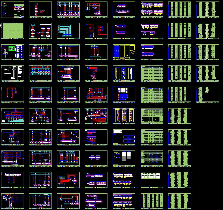

There isn't a predefined size and the 12 sheets is an example, normally is 30+ files in the same sheet.
This is a client requirement, he wants a single sheet with all the drawings in it...
This is a finished example of what the client wants, done manually:
Thank you in advance for your help!
