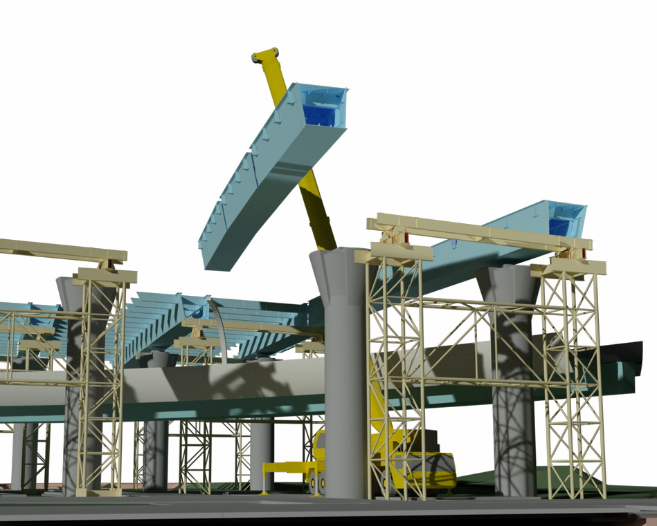

Hello philippe JOSEPH.
I didn't understand the question about text style and UCS, you can easily fix them.
3D geometry taken from the Liebher website. The main problem is the size of the original file is 18.5 Mb, after optimization it is 4.5 Mb
A 3D block is created on the basis of a 2D block,
therefore, it consists of 2 parts, the upper (vertical plane) and the lower (horizontal plane).

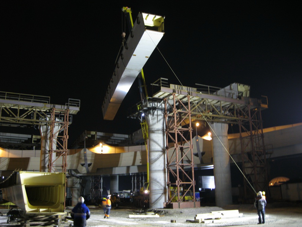

A 3D crane block is needed very rarely when the crane operates in a very limited space:
