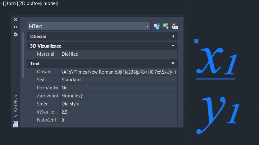

Can anyone help me please how do I create a math expression/equation such as attached image in AutoCAD 2014? Thank you

Do you mean the stacked text? Or the graph of it?
The stacked text can be entered as:
x1/y1
in MText and confirming the stack prompt. Or selecting the text and picking Stack/Fraction in the context menu. If the "1" should be displayed as lower index, it may become more complicated and you will need to use formatting codes manually (or an OLE object).

So, what should I do? I can do the fraction by using stack, but I can't do the subscript. Or, I can do the subscrĂ­pt by using stack, but I can't do the fraction. You need to choose one of them.

The subscript/superscript method is viable in most cases - just make sure you are using a font with the full Unicode character set (e.g. Arial Unicode or Times New Roman). Then e.g. the "subscript 1" is the Unicode character \U+2081.

Just type it in the text - it will autoconvert to the subscript 1 (if you have the right font).
