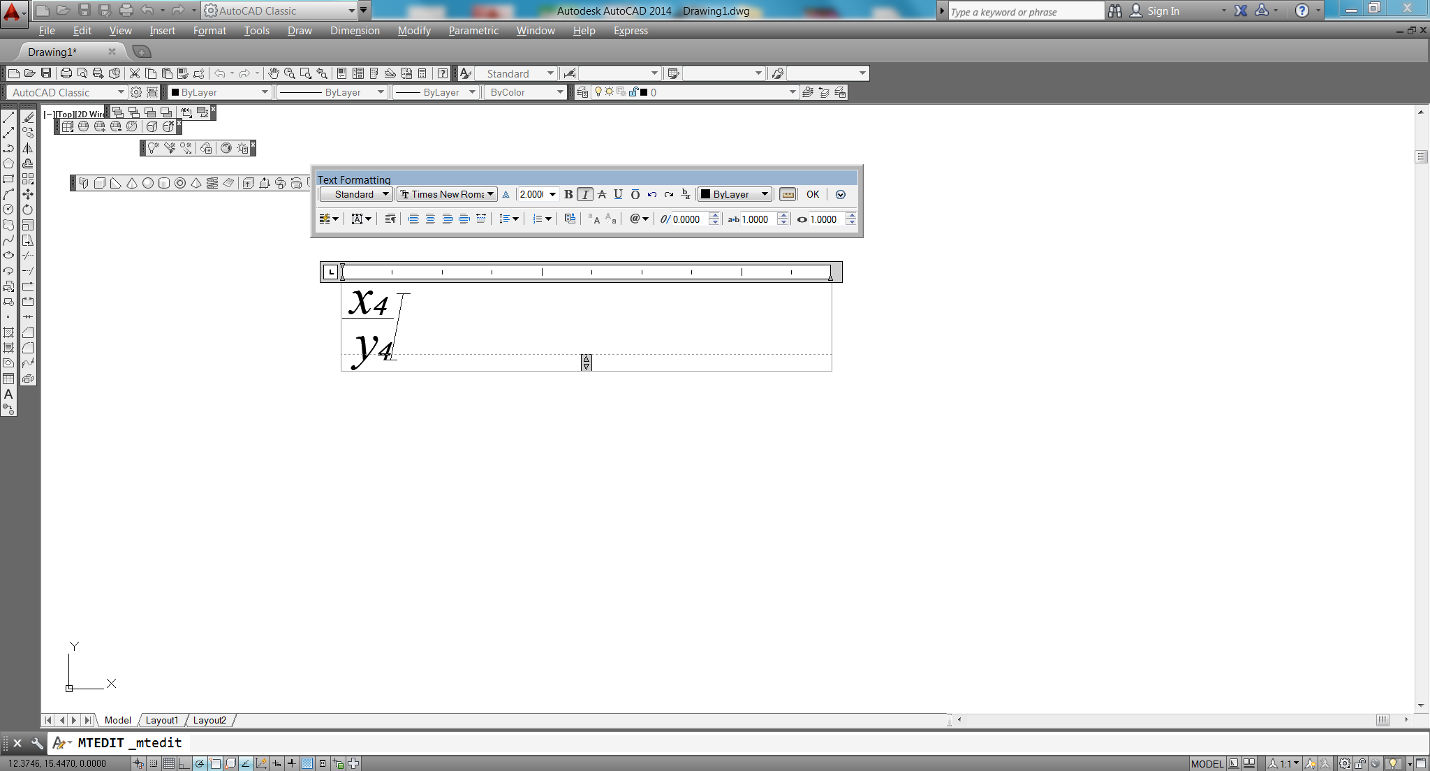

How to make the subscript of 4 not italic?

Originally posted by dery dery wrote:
... what is the Unicode code of subscript of 4 and the answer is "U+2084". .... Why nothing is happened? ....
You are missing the backslash before the U.

The italic style cannot be set/reset just for the index. Resp. it can but not through the standard MText UI.

Why the subscript of 4 of mine get italic too? What I want is the x and y is the one that italic, the subscript of 4 is not italic.

My Times New Roman (times.ttf) is 1.2MB long, version 7.0, installed probably as a part of MS Office 365, under Win10. But it should be included in Win10:
https://learn.microsoft.com/en-us/typography/fonts/windows_10_font_list

Yes, the blue one is same of what I'm experiencing. Is there any solutions for this problem? I don't want to use another font than Times New Roman.

Probably a font issue (try a different one) - this is what you see with a full Unicode font (white) and with an incomplete one (blue):

The subscript I'm doing is 4. When I enter the Unicode of subscript of 4 after the "x" letter, it disappears. It doesn't display the subscript of number 4. And the font I use is Times New Roman. What should I do to make it appears?
