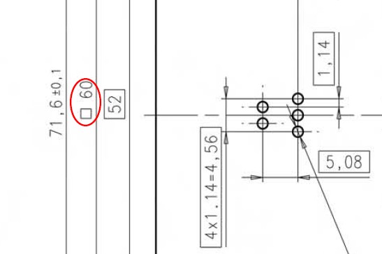

Hello All,
I'm back with more questions.
I have a drawing showing a Square Symbol in front of a dimension. Don't know what it means.
Thank you in advance.
KenJG

Hello Kenjg, I suppose that that "square" symbol means that the dimension is a square of 60 x 60.
It can be when you have only one figure to show a part and not 2 or 3 figures.
I hope it's not a problem of fonts ( but previously  you said that you where drawing DWG files from paper drawings ).
I hope it's not the symbol of diameter ( Ø 60 on this side of the atlantic / 60 DIA. on your side ).
Where did you get that drawing from ?
Can you ask the person that send you that drawing about this ?
