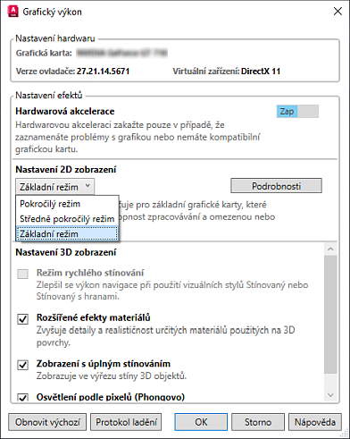

If the settings won't help, in AutoCAD, in the GRAPHICSCONFIG command dialog, select the "Basic Mode" option in the "2D Display Settings":
