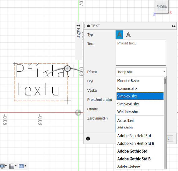

How can I set a single-stroke text font in Fusion 360?
A - answer How can I setup the font in Autodesk Fusion 360 to draw text in a single line (single stroke)? You may need it e.g. for a simple text engraving.
Just set one of the simpler SHX fonts, such as Simplex or IsoCP. Beware, SHX fonts are hidden in the font list at the very top, yet above the TrueType fonts starting with the letter "A"! (SHX fonts do not display previews in this list.)
