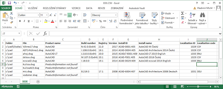

You can also use the DWGintVerCon Windows console application (.EXE) to perform batch report with similar results:
