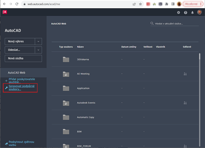

If you need to use a non-standard font (.SHX) in your DWG drawings processed in the AutoCAD Web version, you need to install it first - similar to the desktop version.
Upload the necessary SHX file using the "Manage Support Files..." function on the AutoCAD Web home page.

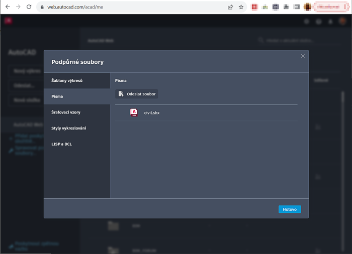

Clicking this will take you to the "Support Files" page. From there, go to the Fonts "folder" and then use the "Upload File" function to upload your .shx file here.
You can then use your added font in the DWG drawings you open.
