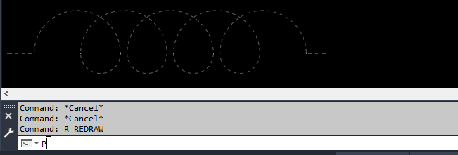

How exactly does the shape need to match?  This is a simple Polyline with all 180° arc segments, easily drawn with Snap turned on appropriately:
You can fiddle with the proportions, how close the loops are to each other, etc.

The Polyline version:
The green dots and dashed dark grey where-it's-headed path are for visual reference -- in this case, the ends of the larger upper arc segments are 13 drawing units apart, and the ends of the smaller lower arc segments are 6 units apart.  Snap is turned on at 1 drawing unit.
You could also just draw Arcs and Copy or Array them, then join them into a Polyline.

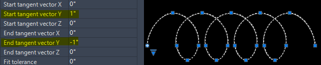

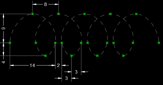

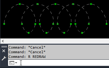

For the Spline version, more defining points are appropriate than for the Polyline of all half-circle arc segments.  These are the spacings/proportions I used:
to do this:
Then I did this in Properties to get the end directions to look better:
Edited by Kent Cooper - 12.Jul.2024 at 15:11

As I can see on the symbol, does the Start and End Tangent Vector Y in inch unit?
Back to Top
Kent Cooper View Drop Down
Senior Member
Senior Member
Joined: 12.Mar.2013
Location: United States
Using: AutoCAD2020, 2023
Status: Offline
Points: 687
Direct Link To This Post Posted: 12.Jul.2024 at 14:25
Originally posted by dery dery wrote:
.... does the Start and End Tangent Vector Y in inch unit?
It's in whatever drawing units are current in your drawing settings, as all entries in the Properties palette always display things.  Just make the start and end tangent vector Y settings equal in value but opposite in sign.  The start-positive and end-negative in mine are appropriate to the direction I drew the Spline, but the opposite would be needed if drawn up-side-down, and if the whole thing runs vertically, use X instead of Y, etc. -- you'll figure it out  It doesn't need to be 1 unit, but that made a good "look" for me at the size of my spiral -- the best appearance could be a very different value depending on the size of things.  You can even play with both X and Y if you don't want the ends springing vertically off the "base" line, to match the fact that in this configuration the Spline doesn't quite cross the base line exactly vertically at intermediate crossings.

Mr. Kent Cooper, why I can't find the "Start and End tangent vector Y" in my AutoCAD 2014 Properties?
Back to Top
Senior Member
Senior Member
Joined: 12.Mar.2013
Status: Offline
Points: 687
Direct Link To This Post Posted: 19.Aug.2024 at 15:13
Show us what your Properties palette has in the Misc category when you have a Spline selected.
Are you perhaps working with a closed Spline?  They don't have those properties.
