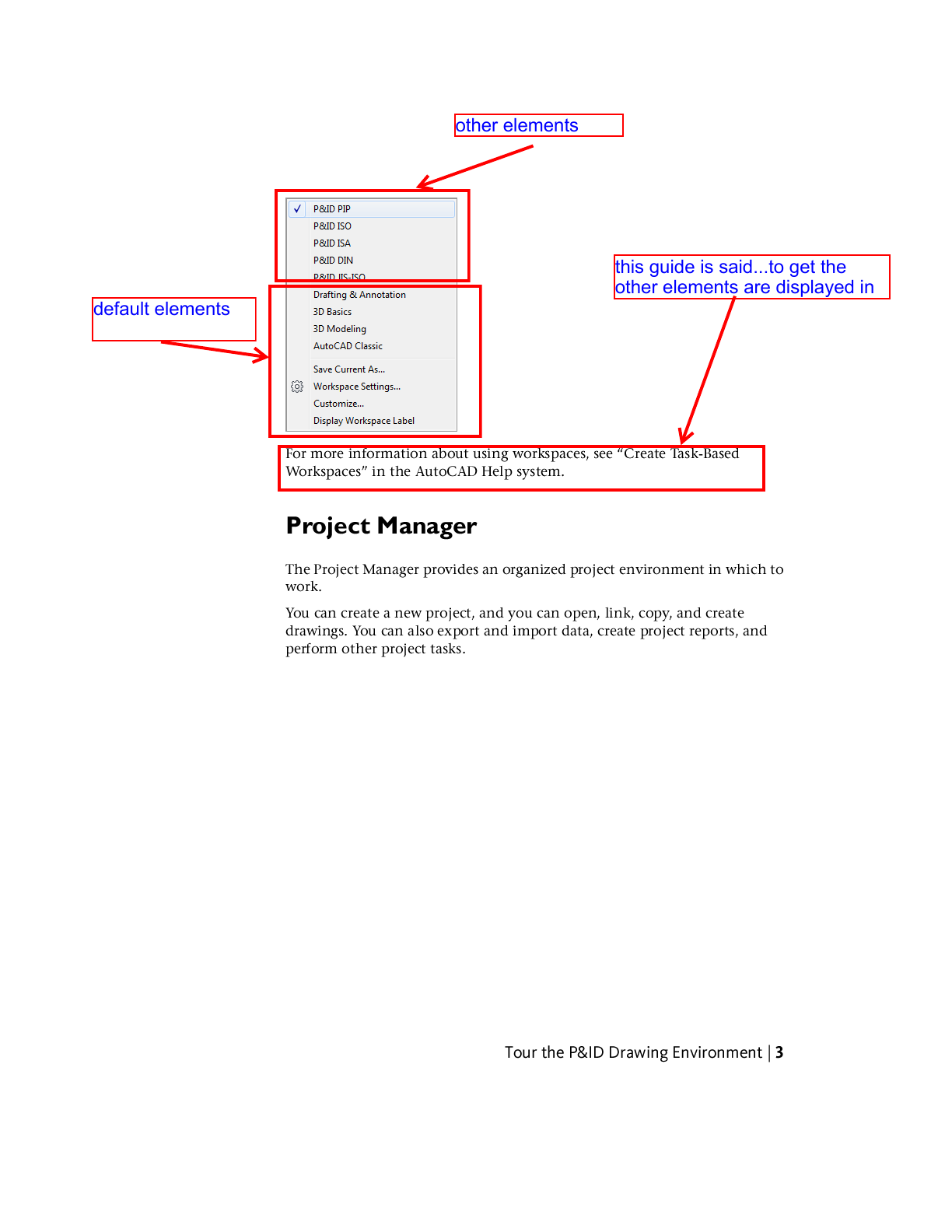

1. It appears you are NOT using plain AutoCAD 2012.
2. You decided to ignore what I asked you to do.
3. You can create a custom workspace based on an existing workspace.  When done do a "Save as".  Apparently you didn't do that either.
I guess my assistance really isn't needed.  Not to worry, no offense is taken.  Good luck with all your tasks.

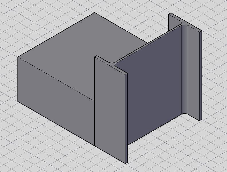

Direct Link To This Post Posted: 14.Feb.2014 at 19:58
You should end up with this result.

John Connor View Drop Down

Direct Link To This Post Posted: 14.Feb.2014 at 19:55
Let's try something else.  First, switch back to a 2Dwireframe visual style.  Assuming you got the desired results in the last post open your tool palettes.  Click on the structural tab.  Find and insert the metric I-beam dynamic block.  Attach it to the lower right hand corner of your 3D solid.
Click on the I-beam.  Click on the blue arrow.  Select IPE A 500.  Your I-beam should get significantly larger.
Use the Explode to explode the I-beam block.
Now using the PressPull command find the approximate center of the beam (between the two lines that make up the web of the beam) and click.  AutoCAD should briefly highlight all the lines and arcs that make up the beam.  When it does move your mouse towards the top of the screen.  Stop.  Type in a distance of 500 at the command line.
Your should now have a3D solid beam standing next to your 3D solid box.
Change to the Conceptual visual style.
How does it look?
