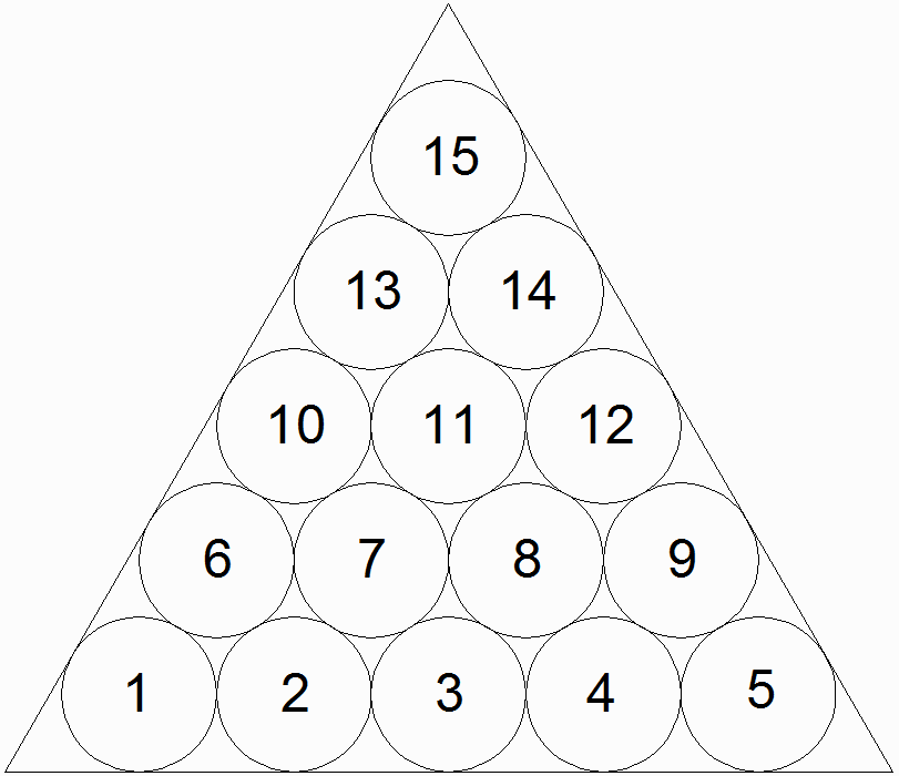

It doesn't use constraints, but assuming Circle 3 in your diagram is supposed to remain tangent to the crossing Lines in the middle, the criteria in the diagram will be met by using CFP and 5 Circles along each edge.
And yes, the CFP command is built to require closed Polylines, because it would be hugely more complicated otherwise, since separate Lines have no inherent relationship to each other.  Just determining whether a collection of six Lines form a regular hexagon would be a difficult task, considering that the Lines might not all have been drawn in the same direction around the shape, and other complications.

Direct Link To This Post Posted: 14.Mar.2014 at 18:07
no, no want to make it with constraints.
see this half worked diagram
http://i38.photobucket.com/albums/e109/sadiq3210/Untitled_zps1e5de5c4.png
Edited by sadiq3210 - 14.Mar.2014 at 18:10

Now I am trying to make the object (circles in triangle - 5 row) using constraint.
