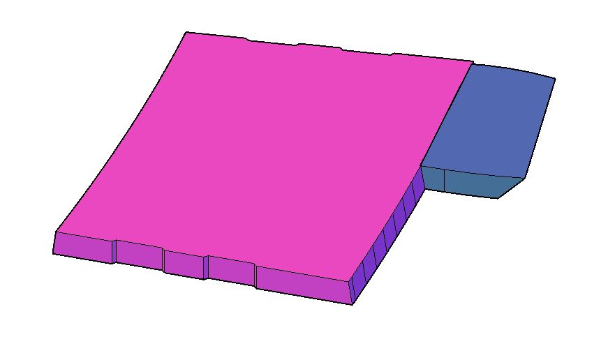

The finished product.

Success.  Once again I created two polyline profiles (top and bottom perimeter) and lofted them.  No need to use the Guides option either.  At this point they just need to be unioned and MASSPROP run on the resultant solid.
The second smaller section confused me at first until I realized the sides were slightly curved.

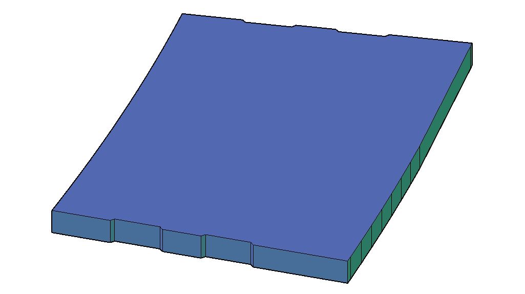

OK...this one is better.  I used the Loft command along with the Guides option.  Before lofting I drew a 3Dpolyline at each of the four corners starting from the bottom profile to the top profile.  I think this one is a keeper.  Now to figure out the best way to handle the remainder.

I think the above may be wrong.  A closer look at your drawing reveals that the bottom and top linework that form the perimeter of the object are not lined up exactly.  Extrude may not be the best command to use although I suspect that Loft will result in surfaces and not a solid.

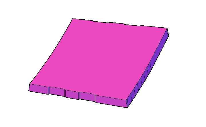

A big portion of your drawing created as a solid using the Extrude command.
I'm not sure why you continue to create surfaces first.  Please explain.

If you separate the large, almost square, area from the rest of the drawing you'll find that both the top and bottom polylines are indeed flat.
