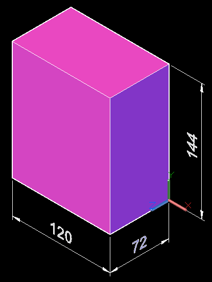

Are you attempting to do something like this?
Yes?  Then one option would be to manually reorient your UCS.  For example, if I wanted to dimension the length of the object I would first use the UCS command > Origin option to place my UCS icon in the lower left hand corner.  Then I would repeat the command type "X" then type "90" so my icon would have the "Y" axis pointing towards the top of my screen.  Once I have that set I create my dimension which in this case is the 120.
To dimension the width of the object I would relocate the origin of my UCS to the lower right hand corner via the UCS command > Origin option.  However, I need to rotate the UCS 90 degrees so I invoke the command again and first type "Y", hit Enter, then type "90" and hit Enter.  Now my UCS is properly aligned with the right hand side of the 3D model and I can go ahead and dimension it.  Now we have our 72 dimension.
Finally, for the height I would first rotate my UCS by invoking the command and typing "Y", hit Enter, then "-90" and hit Enter.  Next I would relocate the origion to the back right hand corner then I would go ahead and dimension the height of 144 as shown.
This was the original way 3D models were dimensioned before the advent of toolbars with 3D orientations already assigned and before the introduction of the Dynamic UCS.
The downside is the user is doing a lot of typing at the command line to reorient the UCS but some CAD techs got so good at it they never adopted another method when it came along.
And here is a sample taken from the mock up drawing used to create the image above.
Command: UCS
Current ucs name:  *NO NAME*
Specify origin of UCS or [Face/NAmed/OBject/Previous/View/World/X/Y/Z/ZAxis] <World>: O
Specify new origin point <0,0,0>:
Command: UCS
Specify origin of UCS or [Face/NAmed/OBject/Previous/View/World/X/Y/Z/ZAxis] <World>: Y
Specify rotation angle about Y axis <90>: 90
Command: _dimlinear
Specify first extension line origin or <select object>:
Specify second extension line origin:
Specify dimension line location or
[Mtext/Text/Angle/Horizontal/Vertical/Rotated]:
Dimension text = 72

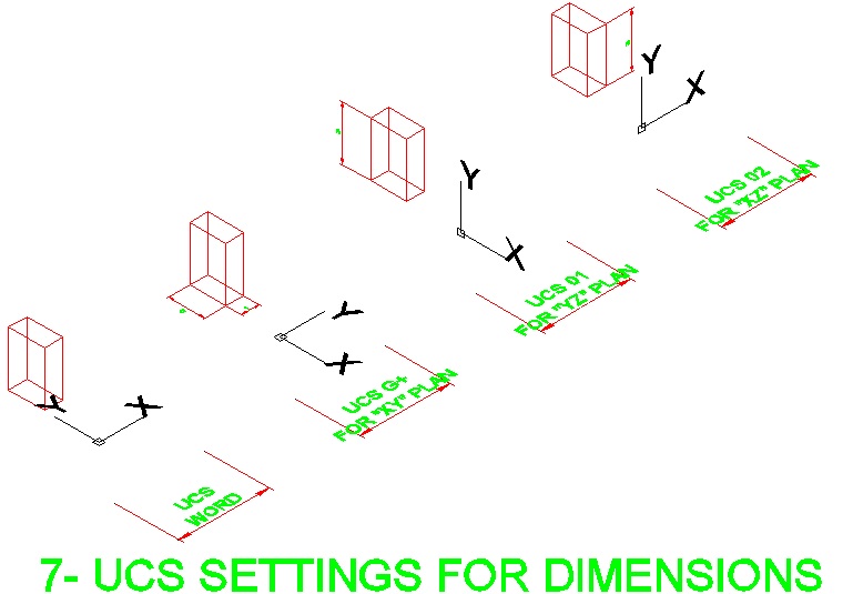

Hello kmorgan, when working in 3D it's important to know how to use the UCS settings and also manage the viewpoints.
Globaly you are comfortable when working in a plan defined by 3 points for example ( command : UCS , enter , 3 ( for UCS by 3 points ) , enter , clic 3 points , enter.
In the file that I have worked with the different steps I have 3 other UCS settings registrated ( in addition of the UCS World and you can see them at the bottom of the file in the figure 7 - UCS SETTINGS FOR DIMENSIONS.
you can re-apply them with the command : UCS , enter , R for recall I hope because I use a french AtoCAD , 01 or 02 or G+.
Of course there are other possibilities with the "dynamic" mode but I found it difficult.
I use also the command PLAN to set a view in the paper space and set my viewport conformably to a certain UCS.
Try and find a book ( or a PDF file like : AutoCAD_2012_command-ref_enu_v2[1].pdf ) to be read instead of the F1 help that doesn't allow you working in AutoCAD at the same time ).
Try and find on the internet : AutoCAD 3D tutorials by Kristen S. KURLAND and read the pages 36 to 49.
