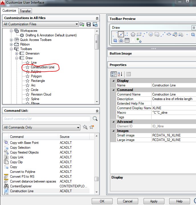

Drag and drop from the Command List!  You're trying to drag and drop from a toolbar which won't work.

How do i replace with Ellipse? Click and drop won't work.  I opened the CUI  I saw the construction line is there but still not able to move to replace Ellipse.

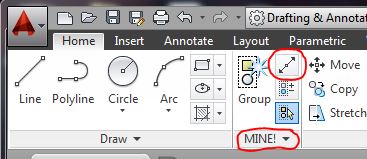

Here's another option.
Rename the GROUP panel to something else (ex. - MINE!).  Substitute a command like Construction Line for one of the commands on the panel such as Ungroup.  Click on the Apply button and close the CUI editor.  Now move the renamed panel such that it falls immediately after the Draw panel.  It should look like this:
Now you're just one click away from your beloved command.
BTW...remember to save your new workspace otherwise the renamed panel will assume its old position the next time you start AutoCAD.
