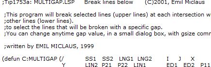

When I Used this tip:
http://cadtips.cadalyst.com/2d-operations/break-a-crossing-line
...and it worked fine!
Downloaded the tip, apploaded file and wrote "thru" and followed the instructions.
John: I often use 200 as spacing between lines.
Do I always have to appload the tip-file when i Use the command? (for instance my "thru" command), or can a upploded file stay in memory?

It seems like I can´t get hold on the functions of Gsize.
I have apploaded Multigap and split the line, but when i type "Gsize" in the command line the answer is:
Error: quit /exit abort
command:
When I read in the Gsize.dcl tip file this is what is said:

You cannot Appload a .DCL file.  DCL files contain settings for dialog boxes; they are not lisp routines.
OK...here's some advice.  Brush up on what lisp files are and how they are created then note that unless they are compiled, in which case the file extension will be something other than .lsp, they can be opened, viewed, copied, edited using an ASCII text editor such as Notepad which comes with just about every version of Windows that I know of.
If you open the Multigap.lsp file and scroll through it you would see that there are two commands in the one file.  The first is MULTIGAP and the second is GSIZE.  If you type GSIZE at the command line, after first loading the Multigap.lsp routine, you'll be able to reset the gap size from its default of 2.
This is what clues you in to a command....
(defun c:MULTIGAP....... or (defun c:GSIZE...........
I have not tested nor have I used the routine so I can't answer any questions specifically how it works.

I Have downloaded the two tip-files. But could only Appload the "Multigap.lsp" file. The Gsize.dcl was not able to appload.
When i Type "Multigap" in the command line, AutoCAD ask me to select the upper line (Gapsize = 2 seems to be default).
I notice that the line i select is divided in the cross section. But how do i choose gapsize?

Most likely the download will be in the form of a zip file so first you will have to unzip the files.  Next place the files in the folder where you keep all your custom lisp routines.  Use the APPLOAD command to load the lisp file (Multigap.lsp).  You'll have to click on the Browse button and migrate to the folder previously mentioned to locate the lisp routine.  Once loaded type MULTIGAP at the command line to run it.
