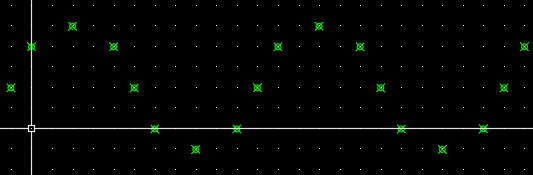

Direct Link To This Post Posted: 29.Apr.2024 at 13:56
Originally posted by dery dery wrote:
How do you positioned the green points location like that?
With the POINT command, with Snap turned on so they are all at grid locations.  They are there in the image only to illustrate -- it is not necessary to have them there if you can visually pop to positions in that kind of regular relationship.  In the case of the relationship in my image, the relative position of each location is like a Knight's move in chess, but you'll need to experiment to decide whether that makes a shape enough like what you want.

Direct Link To This Post Posted: 25.Apr.2024 at 19:58
Well, this may not be any more precise about matching the wave shape, and seems like a lot of work compared to other approaches, and hugely more difficult if you need to adjust it.  But I would do it with Snap turned on and a series of regularly-spaced positions.  Here, Snap and Grid are both set to 1 drawing unit -- note how the cursor pops to only grid positions.  I pre-positioned Points [green] just to illustrate what I was up to, but they are not needed.  You will want to experiment with the arrangement for "close enough" precision.  This is in a SPLINE command.
