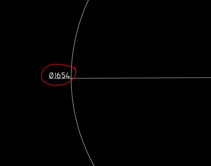

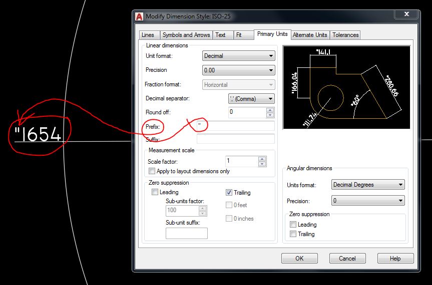

Then you overrode it manually because when you look at the image you posted the < " > symbol is clearly in front of your dimension.  Or is that a fake image?
Start a new drawing and specify the Technics font.  Remember to check your Dimension Style too as you want the same text style/font to be specified.  Then draw a circle of the same diameter (1654) and dimension the diameter.  What happens?  Does the diameter symbol now display properly?  Yes or no?

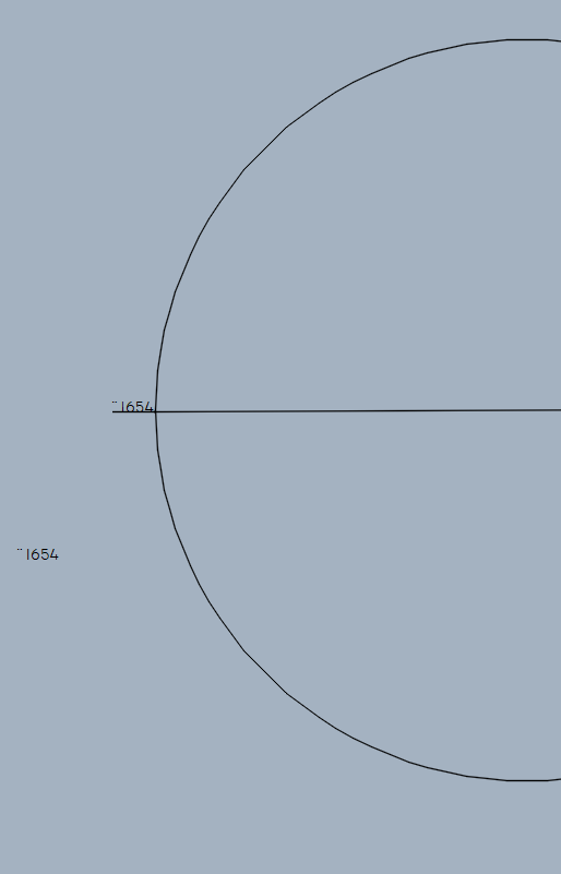

Direct Link To This Post Posted: 20.Dec.2017 at 13:51
Open the attached drawing.  Do the diameter symbols display both in the dimension and in the plain text entities?
The drawing was saved in 2010 file format so you should be able to open it.

Are you sure you are specifying the correct font?  Did you substitute the font for the Style called Standard or create a new dimension style?
Let's see a screenshot of your Style dialog box and your DimStyle > Text tab dialog box.
The only other thing I can think of is that your copy of Technic is either corrupt or the wrong version.
