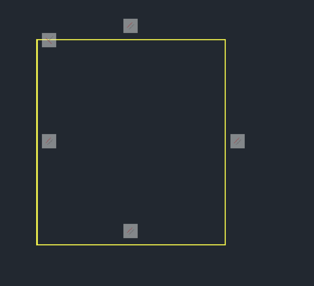

Please Tell me how to turn off parallel, right angle windows, when I select an object!

Hello tokoko, if I understand well you will have to delete the constrain with the DELCON command after having selected the constrains that you want to delete.
Eventually see this on the internet ( internet is your frien ):
https://www.autodesk.com/support/technical/article/caas/sfdcarticles/sfdcarticles/How-to-turn-off-and-delete-constraints-in-AutoCAD.html
