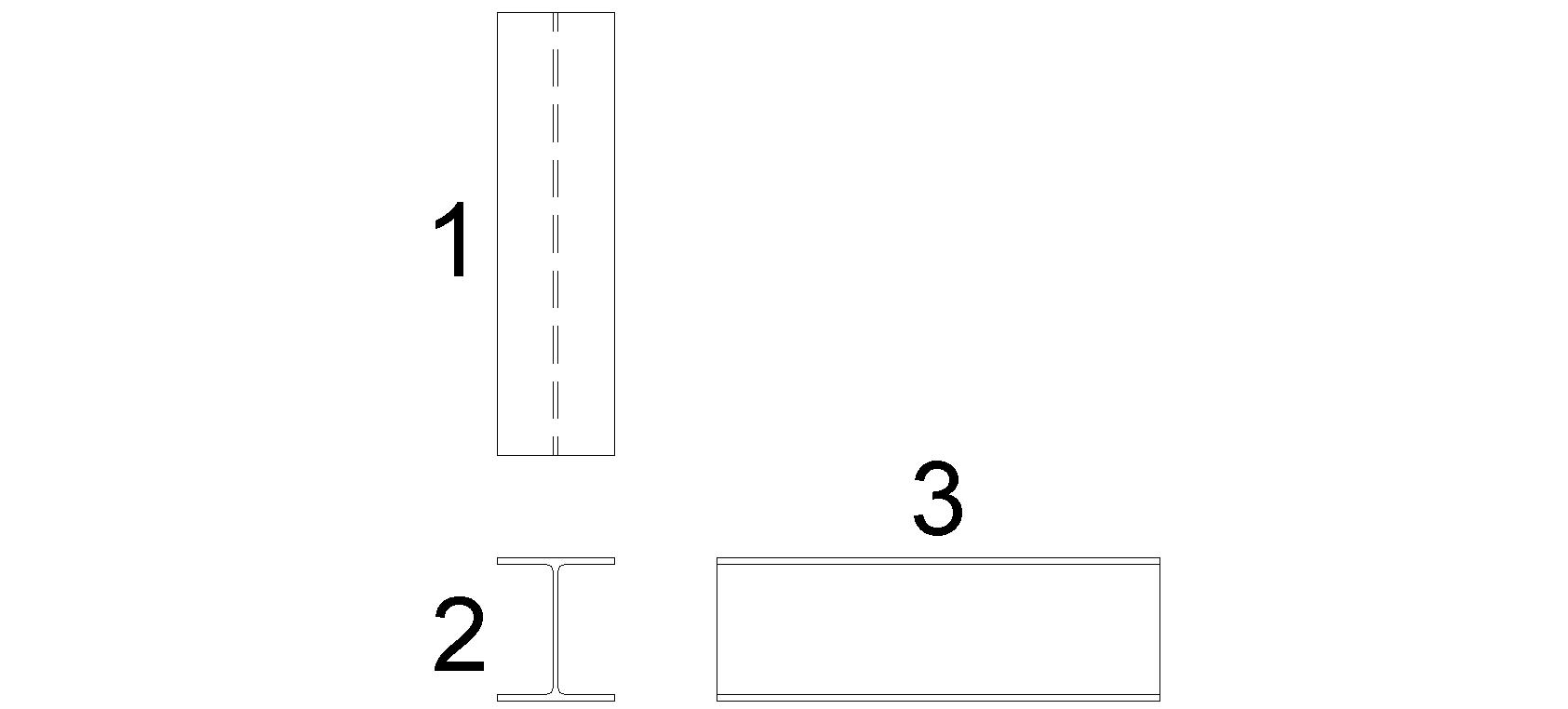

I've described two ways to show a beam and neither are what you are looking for?  Then forget my previous suggestions as I don't think anyone has gone through the trouble to do what you are requesting.  Until I see an image posted here at the CADforum I think I'll have to stop.
Are you drawing a beam in elevation view?  If so, front side or right/left side?
Somehow, some way, you should be able to describe, in words, what view of a beam you are drawing.  How tough can it be?  Pick a number:  The beam shown below is a W250x200x49.1

sorry , english is not my native language and i cant explain better cuz im not engineer.
its number 3.

Looks like we have a winner folks.  It's number 3!  Yeah!
1 - Top view.
2.- Front view.
3.- Side view.
Try the suggestions Cad64 provided and let us know if that works for you.
