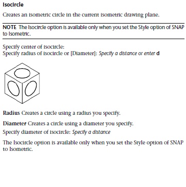

Hello Kent, I have uploaded an updated file : ELLIPSES WITH DEGREE-01B.dwg showing the 2 cubes elaborated by you in pure 2D and me a flatshot of a 3D solid and it shows a little difference in the X dimension ( the other Y and Z being = 50 ).
See at the bottom right of the file.
In fact all the discussion is about these X , Y , Z dimensions...

Originally posted by philippe JOSEPH philippe JOSEPH wrote:
.... the 2 cubes elaborated by you in pure 2D and me a flatshot of a 3D solid and it shows a little difference in the X dimension ( the other Y and Z being = 50 ). ...
That's because the 20- or 25-degree "rotation" of the Ellipses on the top and right faces of my drawn-all-in-2D "cubes" are arbitrary round-figure approximations that look sort of close to what the real appearance would be.  Your Flatshot version, coming from a real 3D cube viewed at the right angle to get the 10- and 40-degree angles for the base edges, results in a true rotation of those Ellipses of about 22.622 degrees.  Presumably if I went through the process using that, instead of the approximated 20 or 25, it would match yours on the other edge length.
