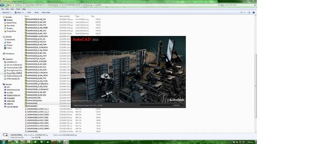

i was trying do to apply that tip but after that the result is AutoCad when starting stays at the loading screen "Preparing working environment...LAYER",attached screenshot.

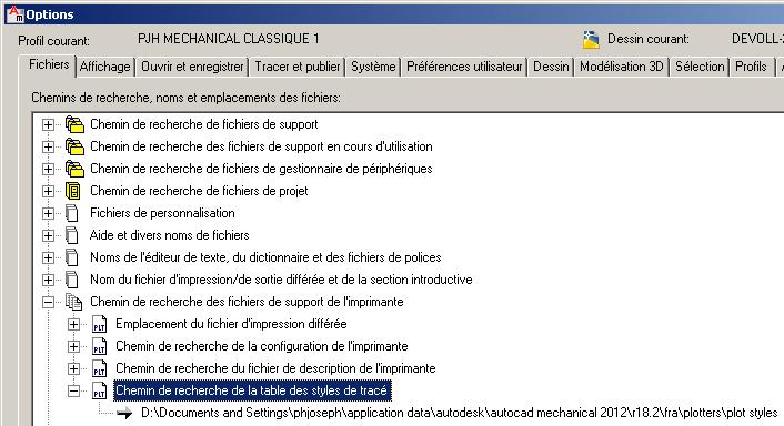

Yes, AutoCAD shouldn't freeze with a PDF print.
I remember that our AutoCAD slowed when we had our .ctb files not loaded in our (C) or (D) disks but in the standard place defined in :
options, files, ... as shown up here.
