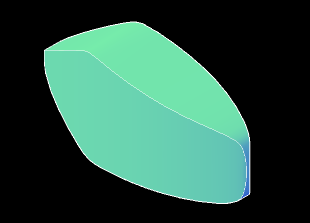

Posted: 24.Apr.2015 at 12:04 |
One possible outcome. I had to copy and union one of the 3D objects before running the INTERFERE command. |

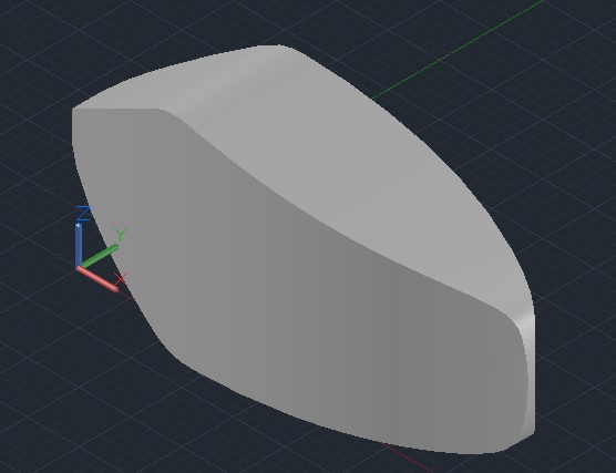

I finally figured it out.
I had to extrude both shapes then line them up. Then click intersect. What I want to know now is how to make it rounded like a plane's fuselage. Then I can test it with CFD. ![]() Edited by Aerodynamicguy - 26.Apr.2015 at 11:01 |
John Connor
Senior Member
Joined: 01.Feb.2011 Location: United States Using: AutoCAD 2018 Status: Offline Points: 7175 |
Posted: 26.Apr.2015 at 13:19 |
Rounded? You might try the Fillet command with the Chain option.

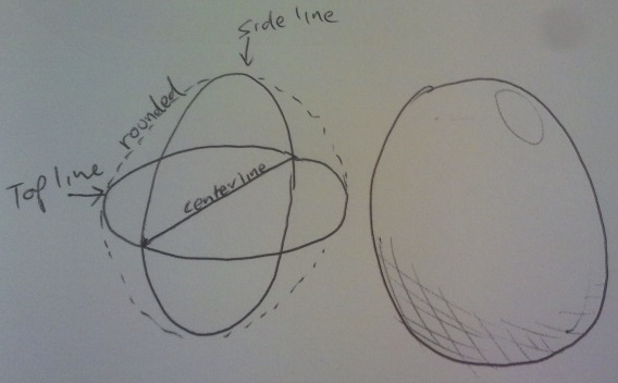

Using the sideline and top line as a guide for the rounding.

SEANT
Groupie
Joined: 09.Jan.2012 Location: United States Using: AutoCAD 2016 Status: Offline Points: 31 |
Posted: 26.Apr.2015 at 16:48 |
It looks like you need to use surfacing techniques to get to that kind of shape. Your original geometry looked symmetrical enough so I limited it to one quadrant. I then used 4 copies with the SCULP command to get the solid.uploads/244286/HowBySurfQuad.dwg
