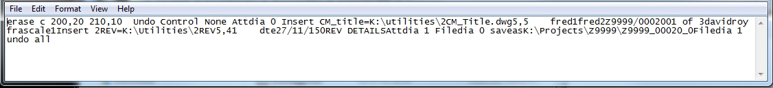

Hi all,
New to the forum and this is my first post which I hope someone can assist me with.
I have started using AutoCAD Electrical 2016 (just moved up from AutoCAD 2008!)
I use an access database to store information about the drawings (DWG No, Customer, Revision etc) and also to aid in configuration management.
As part of this database there are various VB scripts ran, these gather the information and create an AutoCAD script which in simple terms - opens an A3 drawing template, inserts a drawing info box (a block which has attributes) and populates it with the information from access.
This worked a treat in 2008 but I am having issues with 2016.
I cannot workout how to get the script to write to the attributes - when the script is read it sees the text as a command rather than a description that needs to be put in the 'value' field of a tag.
Has anyone got any ideas on how an AutoCAD 2016 script can update attributes in a block please?
If I need to supply more info please let me know and I will do my best.
Thank you
David

The below is a screen shot of the script generated by Access which AutoCAD 2008 will happily use to populate the drawing info box.
This script works in Electrical 2016 until it see 'Fred1' when it falls over because the text is seen as a command rather than info that needs to be moved to an attribute.
Hope this helps clear my query up a bit.

and this is what it does in 2008.
the important bit is in blue
when I insert a block in 2008 the attribute value dialogue is automatically opened - this does not happen in Elec 2016
my question now is how to achieve this in Elec 2016? !

In case anyone needs help in the future
CLIPROMPTUPDATE set to 1
ATTREQ set to 1
Stops dialogue boxes appearing in Elec 2016 and lets you use the command line to type in information
