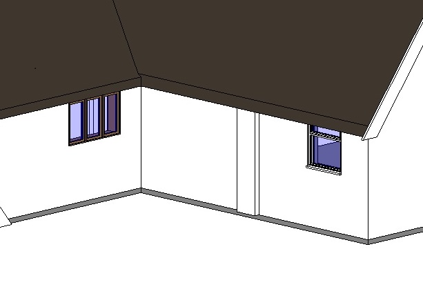

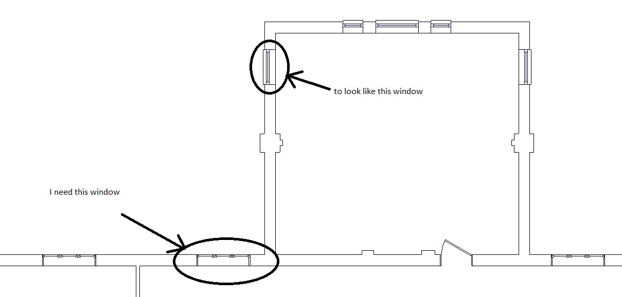

Hello all,
I am fairly new to Revit, and the only one within my company that uses it. My boss would like all the windows on plan view to look the same. Although the windows are different i am wondering if there is a way to display them all the same.
Because the windows are different does that mean the cut through is always going to look different or is there a way to create the same plan view for all window families regardless of the window design.
I have attached my example.
Hope that all makes sense.
Thanks in advance

Is it because you used two different TYPES of windows?  Ex. - double hung vs. casement?

Yes that's correct, one is double hung and one is casement. So if i use casement its always going to look like that?

Of course it is.  Why would you expect different types of windows to look the same in plan view?  Why are you mixing different types of windows anyway?

Like i said, i am new to Revit so i obviously have a lot to learn. I thought maybe you could edit the families to show a different design.
Well as im sure you can tell i dont know much about families so i downloaded these two types from the internet. I chose these two becasue they matched closely to the ones on the building i am drawing. So are you saying i am able to create these two types of windows (the ones i want on my building) that look the same as the ones i currently have but under the same type, therefore showing the same type window on plan view?

I suppose you could but personally I don't see the point of doing that.  Different window types have been drawn using different symbols long before CAD was even invented.  If you don't believe me go to the nearest library and take a look at any book on architectural drafting and design.
Let me ask you this.  If you have a regular door, a bifold door and a pocket door would you also draw all three using the same symbol?

Okay well firstly, the reason i am creating this model is for nothing more than a 'pretty picture' so it doesn't matter whether it is actually the correct window or not as long as it looks correct on plan and in the other views, so I suppose it makes sense to choose the correct window, but not knowing a great deal about families and after searching for hours online for a window that I thought was closely related to the one on my photos, this is what i came up with.
Please may you answer this, 'So are you saying i am able to create these two types of windows (the ones i want on my building) that look the same as the ones i currently have but under the same type, therefore showing the same type window on plan view?' - or is that simply not how it works, ie, it would have to be a completely different window to show that window plan view design.

Revit is 3D is it not?  Therefore it should follow that the 3D model is the basis of all truth when 2D views are extracted.  You want to show one thing in the model and something entirely different in the plan view.  Sorry, but I don't agree with that philosophy.
Bottom line: It's your drawing.  Create a new family that has both a double hung window and a casement window and make them look the same.  The building information attached to the two windows however has to be different otherwise when a bill of materials is generated how do you know how many of each TYPE of window will be required?

I understand what you are saying now.
Basically my boss said when he looks at the casement window on plan view it doesn't look like a window to him, saying that he has no knowledge of Revit and i think he may just need to adjust, being use to one simple generic window plan design on CAD. I shall relay what you have said to my boss later on.

You never said where you searched.  Maybe its different in the UK but I searched three different US manufacturers and each one of them make available 3D blocks specifically for use in REVIT and they do it by type of window.
