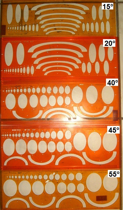

What is meant by ellipses with degree (please see below image for more detail) and how do you draw it?

Hello dery, please find an example of ellipses with degree.
In fact an ellipse is a circle that you look on its side with a certain angle ( degree ).
If you have an angle of 0° you will only see a line, if you have an angle of 90° you will see the circle.

Direct Link To This Post Posted: 27.Aug.2018 at 17:37
Dery, what you see on the picture are old drawing plastic parts to be used on the drawing board.
If you want to draw your examples you can do it in 3D or draw a circle and do some "angled projection".

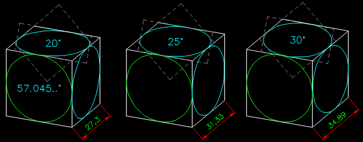

Kent COOPER, I have uploaded the AutoCAD file : ELLIPSES WITH DEGREE.dwg in the CAD/BIM Blocks library because I'm trying to draw the cubes and the ellipses.
For the ellipses your methods looks appropriate to the case but I'm not abble to draw the cubes in 2D ( dimensions x , y  , z in relation with the angles defined in the 3 figures ). Can you help ?
 I have tried to draw it in 3D with the concept define in the test :
Figure 11.47 . Angle size determines viewpoint of object but it doesn't work vith the command viewpoint.

Direct Link To This Post Posted: 10.Sep.2018 at 18:24
Obviously the 10-degrees-up-on-one-side and 40-degrees-up-on-the-other in the original left-most image don't mean the same thing as the "From the X Axis" and "From the XY Plane" angles in your VPOINT dialog box images.  I'm not sure how to translate between them, but it certainly would involve some potentially complex trigonometry.
But I now question the legitimacy of the original image.  I did manage a fully-2D way to get a 55-degree- and two 25-degree-rotation Ellipses to sit cleanly in Lines representing a "cube" with those 10- and 40-degree base-side angles.  But I'm reluctant to describe how, because if all was legitimate, the Ellipses that touch shared "cube" edges should touch them in the same place, but they don't -- their touching points are a [not huge but] meaningful distance apart.  I suspect that for those nice round-number base-side angles of 10 and 40 degrees, the true "rotation" or "degree" of those Ellipses would not really be their nice clean 55 and 25 degrees.  Do you know where those numbers come from, i.e. how the rotations are derived from the base-side angles?  It would take me some pondering to figure what they should really be, and maybe I'll find time to try to figure that out later....

Direct Link To This Post Posted: 10.Sep.2018 at 21:18
That turns out to be the case -- the true "rotation" or "degree" of the Ellipse on the left face of the left-most image [with the base-side angled up at 10 degrees], that they show as 55 degrees, would in reality be a hair over 57 degrees. Likewise the one on the top face of their middle image.

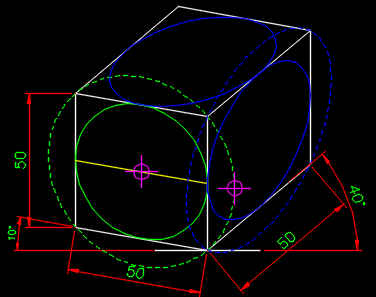

I'm not sure how to get a 3D view to be from the right direction that Flattening it will result in the desired base-edge angles, either.  If I think of something, I'll write back.
In 2D construction, the "problem" in the drawing file of the dimensions of the edges has a solution for a specific degree-of-rotation of the top-of-cube Ellipse.  The one on the "left" face, in the left-most image in the initial message here, is (because the other two have their Ellipses rotated at the same "degree") a rhombus, so 50 units is appropriate there.  And because it's a rhombus, you can build the appropriate Ellipse pretty easily [for the moment, consider only that left face]:
Make an Ellipse using the corners of the rhombus for the axis endpoints [the dashed-line larger green one], put a Line across the middle of the face [yellow], and SCALE the Ellipse down, about its CENter, using the Reference option with the two magenta points as the Reference distance [MIDpoint and APParent-intersection], and the end of the yellow Line as the new distance.  Either of those Ellipses will give you its axis aspect ratio in the (assoc 40) entry in its entity data -- the real rotation of it is the angle whose sine is that number [included in the next image].
That image also shows one way of easily making the other two sides, also as rhombi, as a true isometric version would be, making their Ellipses equally easy to draw in the same way [blue].  BUT in the original image, the Ellipses on the top faces of the cubes all have their major axis horizontal, which the above does not.  For that, the desired degree of rotation of the Ellipse affects the edge dimension along the 40-degree sides.  Determining that involves drawing an Ellipse with its major axis horizontal, and the desired rotation, Rotating copies of that appropriately so that drawing bounding boxes around them [the dashed grey below -- I have a routine to do that] and Rotating those back gives edges parallel to the "cube" edges, then some Moving and Scaling [with Reference option] to get them in the right positions and sizes, and the far-side cube edges in the right places.
I'll upload the CAD file that both these images came from -- same place and same file name with -2 added at the end.
