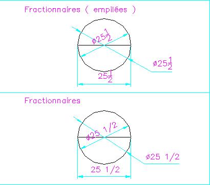

Yes I agree with John that the "units" should be part of the dimensions but you can also use the "fractional" units as shown but without feet/foot :
See also on the internet :
Edited by philippe JOSEPH - 29.Nov.2020 at 12:43
