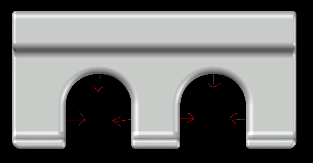

Hello,
I'm not new to ACAD but I am new to 3d modelling. I downloaded an item from thingyverse to 3D print but I need to modify it slightly as some of the dimensions could be tighter. So I converted STL to DXF and then converted all the 3D faces to solid via 'convert to faceted surface' and 'sculpt' commands. I now have an entire 3D solid model which I want to edit but am now stuck as nothing I have tried seems to work. A picture of the item is attached (in top down view) with arrows indicating where I want to modify the dimensions. Basically I want to offset the inside edges by a couple of mm. Can anyone help?
Many thanks in advance!

Hello Denken, I think that you will have to create the solid that you want to add to your model but you can easily rely on the existing solid to do it.
In fact 3D AutoCAD is not easily modifing or with parameters.
I would personally do some regions directly on the existing edges then EXTRUDE and/or REVOLUTION them and UNION them to the existing solid.
Please tell us about your knoledge of AutoCAD 2D and/or 3D on what AutoDAD year / version.
I will try to make an "hand sketch3 of what is to be done.

I've been using ACAD for 14 years, so I have quite a lot of experience in 2D anyway! I do work in 3D, just not with solids - I work a lot with pointclouds so I am used to switching between coordinates systems and views. I have access to versions from 2017 to present.

Hello Dedken, yes the instructions are made to make the object from scratch OR by modifying the object ( see the last three steps.
If it's too difficult as 3D AutoCAD is not easily modified or whith parameters we ( I ) could do the solid if you give all the dimensions defined in the very first step that I think are enough to define the part.
You said that you work in 3D with coordinate systems and views and that's very good; do you want to "learn" 3D AutoCAD or modifying this object is enough ?

I will have a go at drawing the object from scratch and then extruding the regions as you suggest, and we'll see how I get on with it. At the moment I just want to edit this object but long term I do want to acquire 3D CAD skills as I want to be able to create objects myself to 3D print.

Denken, you can't easily "edit" this object like you could do with Solidworks or an other software with parameters ( maybe Inventor is working like this ) but you can modify it by filling the two holes and then recreating thoses holes smaller.
You can easily get them bigger by creating some solids to be SUBRACT.
If you want to acquire 3D CAD skills you will have get a trainning course, find a friend / colleague or dive into some documentation on your own like I did years before, it's possible by simply looking in the documentations at the existing AutoCAD commands.
In the previously related AutoCAD file of mine ( 3D SOLIDS 01.dwg ) I have listed the main way to do solids creation, modification and some tips about the viewcube, UCS and the use of the UCS for placing dimensions, there is a lot to learn.
The good thing is to find the official AutoCAD documentation like it was years before as a PDF file loaded on your "C" disk with a name like : AutoCAD_2012_command-ref_enu_v2[1].pdf but now it's all in the F1 button and it's difficult to work at the same time on your AutoCAD session and with the F1 help.
