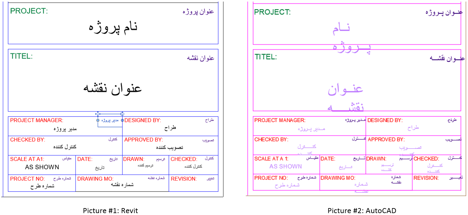

I encountered a severe problem today exporting from Revit to AutoCAD (DWG).
As shown in picture #1, in Revit all texts are in normal condition.
Picture #2 shows AutoCAD DWG file made by Revit via EXPORT command.
As seen comparing two pictures, the problem is changing the alignment of all Text (Mtext) objects to "Top-Left" ignoring the definition of Texts in Revit. Another problem is that changes in the margines of TEXT, wraps some MTexts in AutoCAD.
Should any one can solve the problem?
I apprecate any help or clue guiding me to study.
