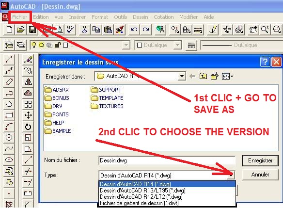

Direct Link To This Post Posted: 04.Jun.2022 at 13:00
FILE / SAVE AS :
