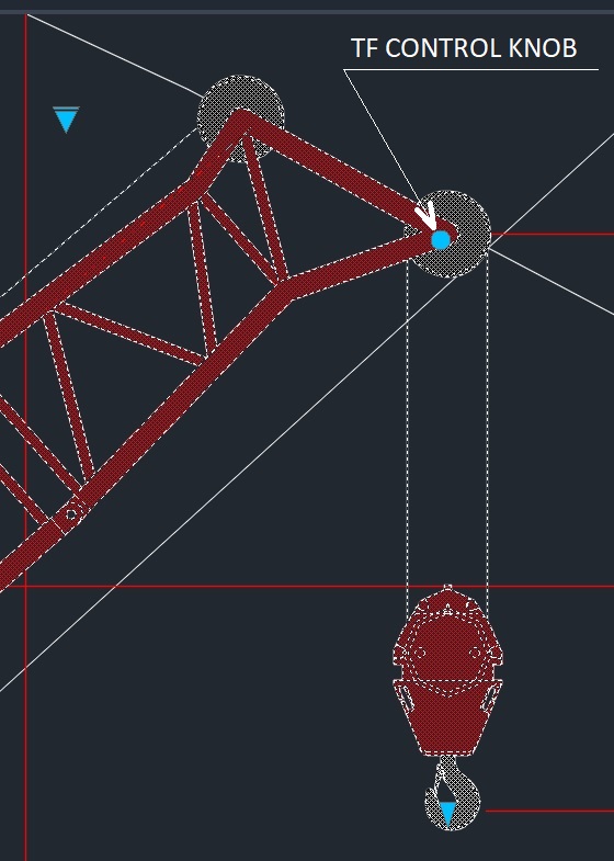

Cfytr, I have looked inside your excellent update and only on the TF jibs the control knob is not centered, little on the 7m jib and growing bigger to the 56 m.
The rest is so good and I'm just not able to do 10% like this.
P.S. Eventually save your file in zoom extends so that the persons see the entire drawing.
The "colored" shapes let me think at first it was only a "print screen" of the Liebherr catalog.
Eventually write in very big capital letters : DYNAMIC BLOCKS.

Unfortunately, for the TF boom, it is impossible to put the control handle in the center of the block. since the angle of inclination of the boom should be counted from the horizontal.

Hello Cfytr, in fact the TF control knob looks to be centered, don't know what hapened.
Anyway the TF configurations are difficult because of the fixed lean angle of the jib ( 0°, 20° or 40° ) to combine with the variable lean angle of the main boom "T".
For the hatched area I saw now your message : The hatching is located on a separate layer, OK for me.
