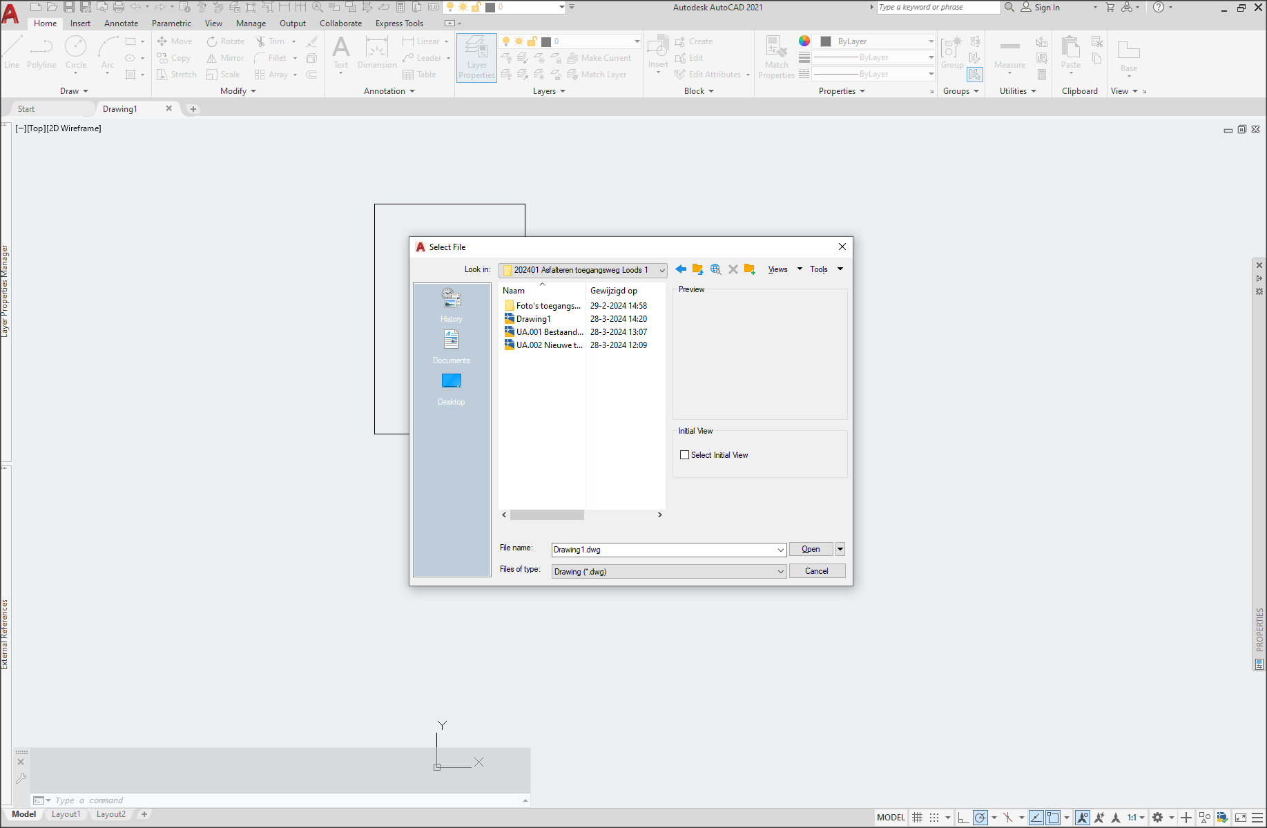

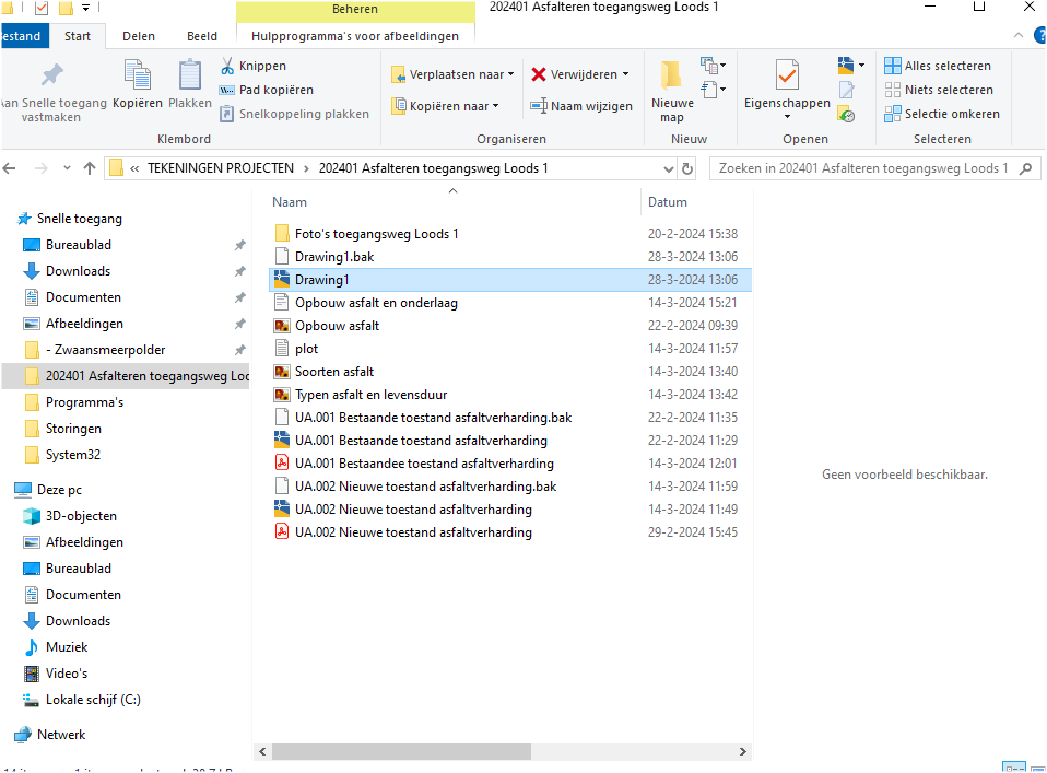

At the moment I have a problem with Autocad 2021 and that is that it does not want to save a drawing with the correct time and date in the explorer.
When I open a drawing, for example UA.001 Existing condition of asphalt pavement, via the explorer and make changes to it and save it, the date and time remains the same as before opening! When I save the modified drawing 'via save as', the date and time do not change either!
See appendix 01
The bizarre thing is that the changes in the drawing are saved.
When I open Autocad and then use the command ā€œopenā€ in this explorer, I see the correct date and time in the drawing when the changes were made and saved. See appendix 02.

Right click on the header in File Explorer and choose Modification Date instead of Date.
